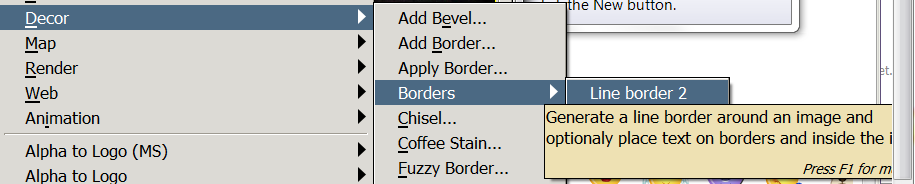

I put in the python for line borders and I have an option in Filters >Decor > Borders > Line Border 2, but when I click on it, it does nothing at all. It doesn't show up in undo, but in Filters it shows Repeat "Line Border 2" and Re-Show "Line Border 2".

I went back and found the link you posted, but it is for 2.2 and when I installed it in 2.6, it doesn't even show up in the menus. :gaah

I couldn't find it under filters, so I put them all into the plug-in folder. It now comes in under filters > borders > Line border 2. The only problem is, when I click it, nothing happens. drats.Image
Yes, I did have an image open....

I never looked at the scripts to see where they were to appear. I thought they were in decor? They are working for me!
I followed your instructions for Line Border, to the tee, but still not working.
