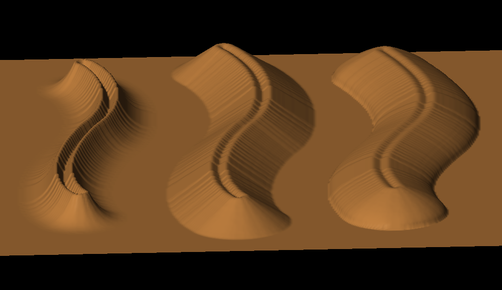

The first script made the edges real sharp and nice.
But the second one is giving a V shape.

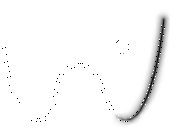

trandoductin, I think the problem you're seeing is that your curves spline needs to be below the diagonal (or else you should be inverting the colors/selection before and after applying your curves).
Here is a simplified version that does not create any layers, but instead paints directly on the selection mask. I do, however, create a temporary channel to perform the Levels operation, since you can't apply filters directly on the selection. I used Levels instead of Curves hoping the curve being applied was sufficiently close to being a gamma curve (close enough for government work, anyway).
The command is available by right-clicking on the path from which you generate the selection. You are prompted for two values: the radius and the gamma. The actual width of the selection will be twice the radius and the "tapering" of the selection is determined by the gamma (the lower the gamma, the more quickly the selection tapers away toward nothing).

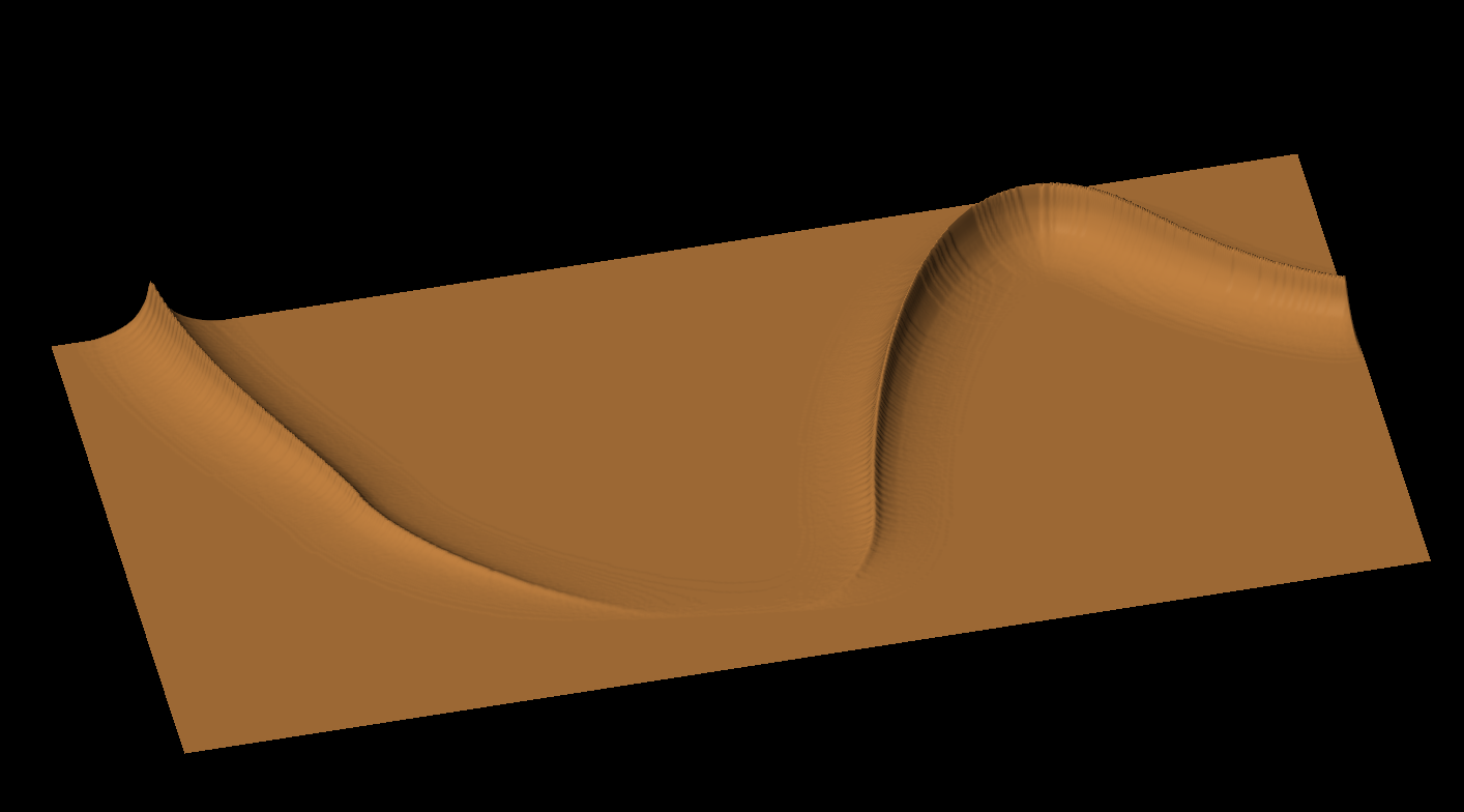

soulgoode that script is good. I like the fact that the curve has interactive options from the gamma.
I still seem to be getting a larger stroke from the path though. I get a little dip through the center of the path.
I would ask how you go about producing that 3-D rendering of the selection.

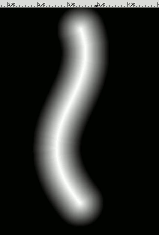

Here is a visual representation of a selection produced (gamma=1). The values of the pixels from left-to-right is always a simple "hump" (black->white->black). There is no dip at the center "ridge" of the selection so I suspect your dip may be an artifact of your 3-D rendering methodology.

I have a software called Carvewrite Designer that I can paste in a height map image and it gives a preview of it in 3D. I suspect the reason I'm getting that indentation is that somehow the script turns the path into a line and then the line into a selection and the selection is what is used to generate the border bevel and then the curves or levels arcs the bevel. And somehow the line that comes out of the path is 10 pixels wide. So it bevels the inside as well as the outside.
If you use this script with a selection on the canvas you can see that it bevels both sides.
The inside bevel that I'm experiencing is visible on the image as well as when I view it as a 3D. I just attached the 3D image to show it better.

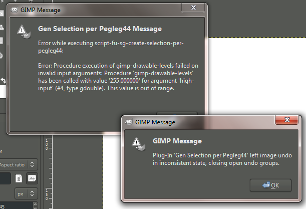

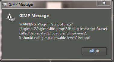

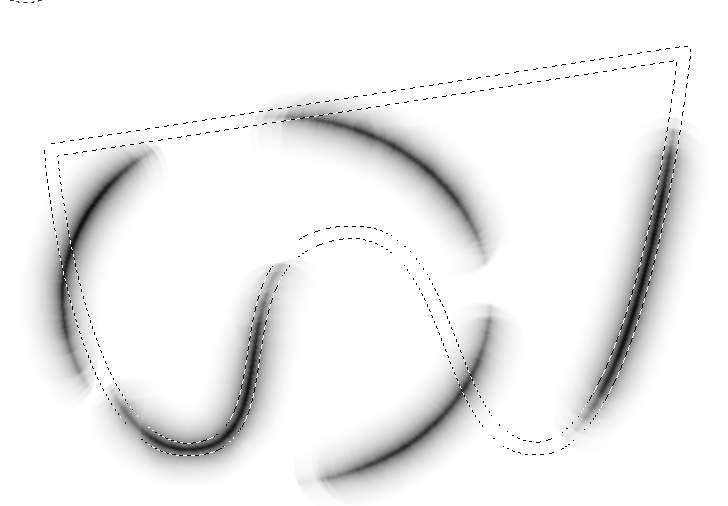

I tried to run the script in gimp2.9 portable and it gave me this message:
And when I put in drawable it gave me these error messages:

The first message is just a warning; the script should still run fine. If you do not wish to see deprecation warnings when running the development version of GIMP, use the "--pdb-compat-mode on" switch.
I still don't understand where the "dip" is coming from, but I have to get back to work now so will check back later.
